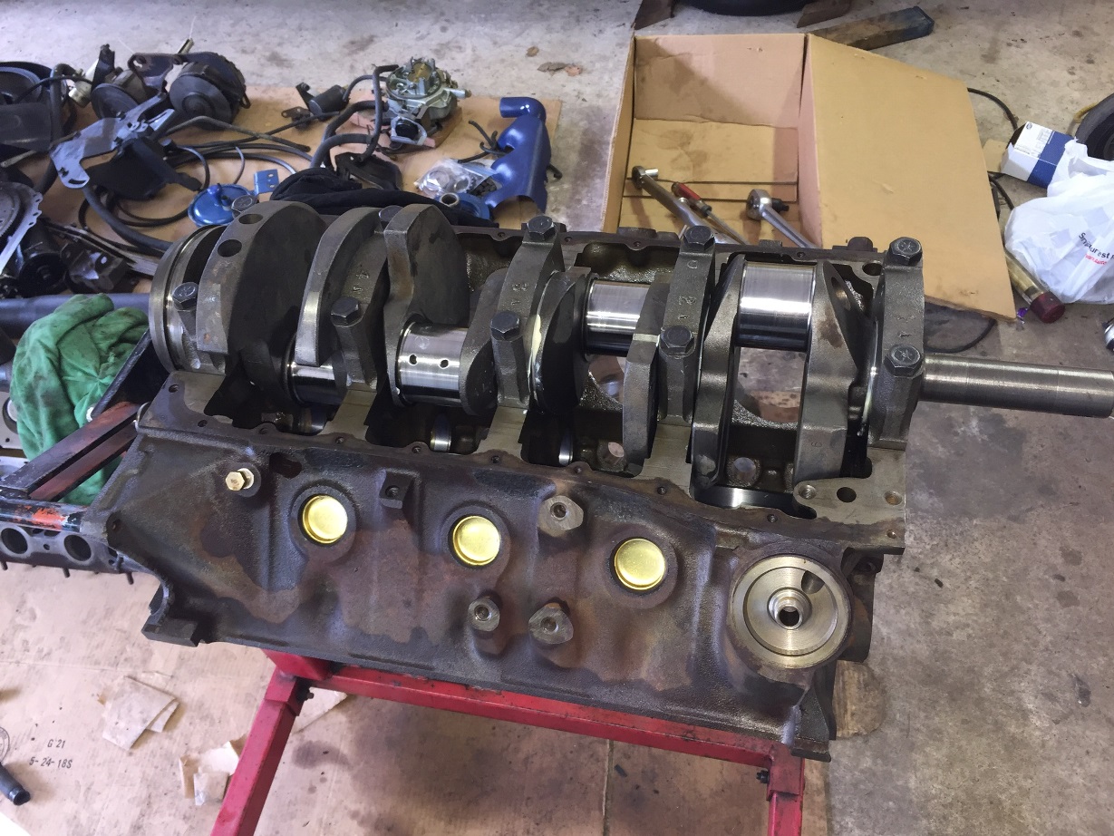

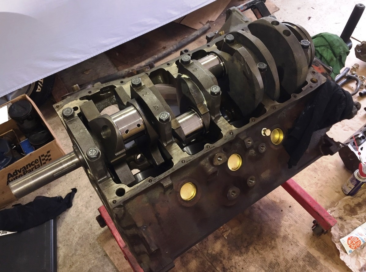

Chased all the threads in the block this morning. Then I installed the rear main seal, bearings and crank today. Oil clearance is .002, checked with the old Plastigage green. Nice, leisurely day in the garage.
