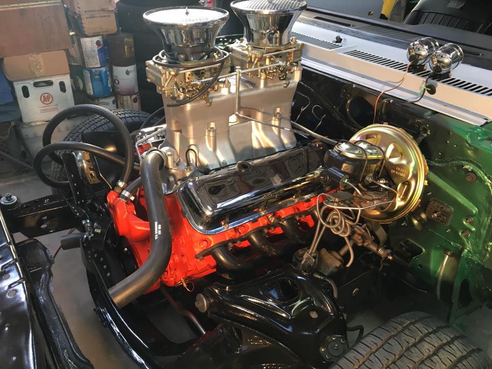

I have a Gen VI 454 +.030" that I'm building. I had the block decked .010" and the heads are razor straight. Does anyone see any issues with running an SCE Pro copper head gasket? They're supposed to be for O ring heads. Mine aren't, but my understanding is that I can use the copper spray and they'll seal fine with flat heads/block. The reason I want to use them is to tailor my compression and quench. Standard gaskets didn't get me where I want to be. With the copper gaskets, I'll be at 9.75:1 and .046". Price is right also at $100.50/pair. I think that will wind up perfect with my roller cam. .241/.249 @ .050 and .625/.625.
https://www.summitracing.com/parts/SCE-P14322
Just because threads with no pics suck, here's a couple of pics of my build progress.
-Dave

I think Grady has copper gaskets on his L88 (in his sweet red lil '67)
Excellent. Thanks Sam. I think it's common to do, I just never have done it before.

Nothin' like a freshly painted BBC! What kind of numbers are you looking for?
I couldn't agree more. I even spent some time grinding casting flash off and smoothing this and that. I wasn't in a hurry... A little cleaning, some Seymour EN48 and a propane torch and whalla. We have a nice Chevy orange big block.
I ran my specs through a desktop dyno and came up with this. If I'm anywhere near it, I'll be happy. She's not a race car. Usually....

Some nice flat torque from 2-5. Plenty of HP to have some fun!!!
That's my thoughts too. Some folks were worried about me being able to take off with 3.31 gears. I had to giggle lol
