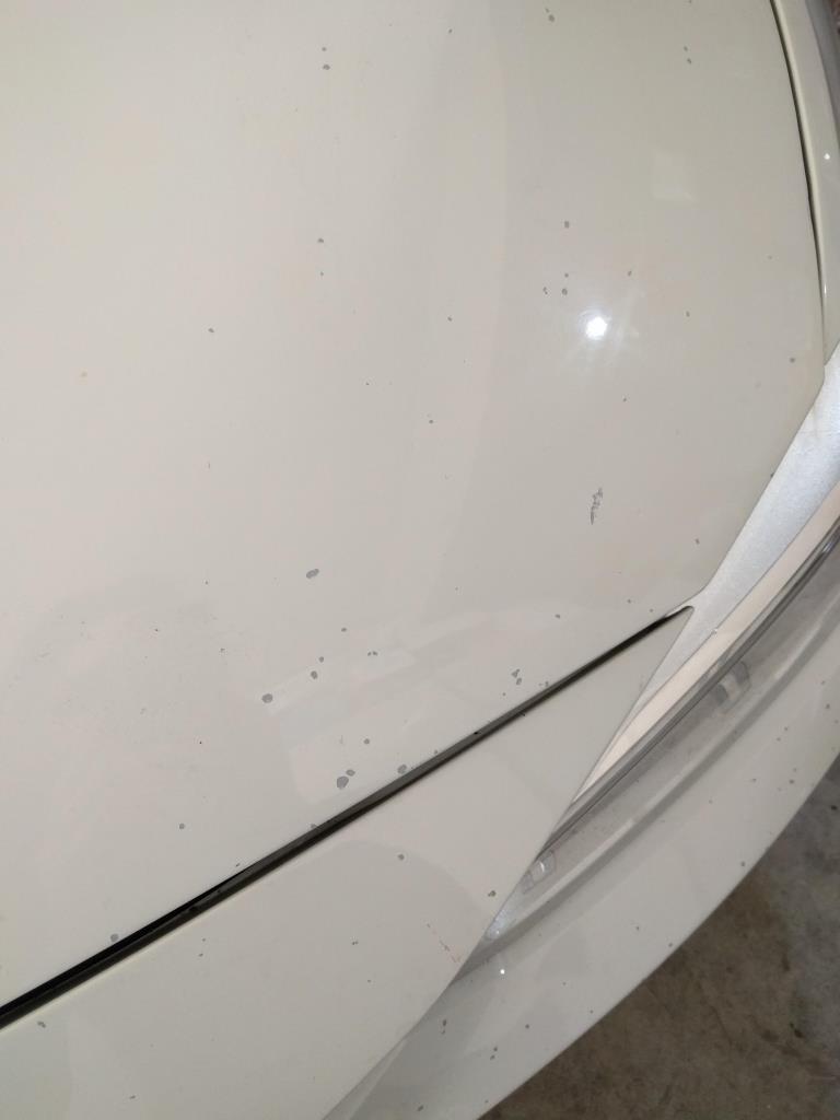

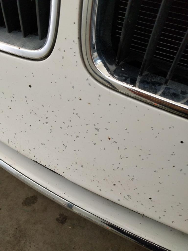

Good luck. Here are the pics, pretty ugly.

YIKES that is ugly. Fortunately for us my wife's car isn't anywhere that bad; in fact there are just one or two minor chips that have occurred during the 4 days of ownership. Our plan is to allow the dealership to make their repairs (BTW, they have been very accommodating) and then have a clear bra installed.
How long after a car has been touched up should we wait before installing the clear bra? Do we need to wait a few weeks / months to allow the paint to cure and/or outgas?
