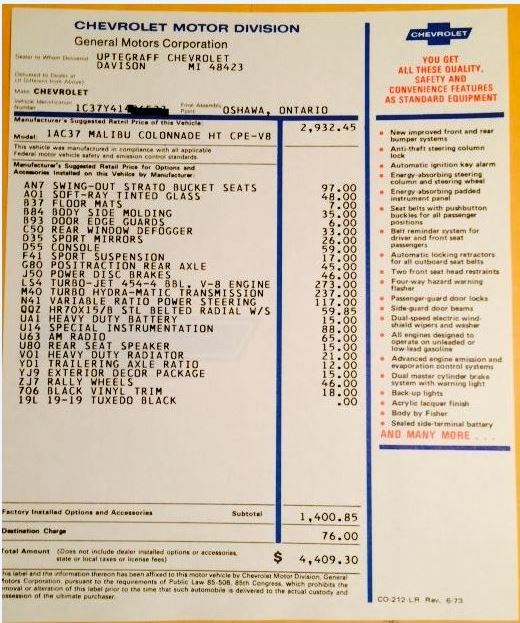

Yes - they came on my '74 Chevelle originally, mounted on 8" wide Corvette rally wheels.

How the heck did you get 15x8 wheels from the factory on a '74 Malibu? 15x7 was the standard RPO rally wheel, right? AS far as I know, Corvette was the only Chevrolet to get a 15x8 from the factory.
