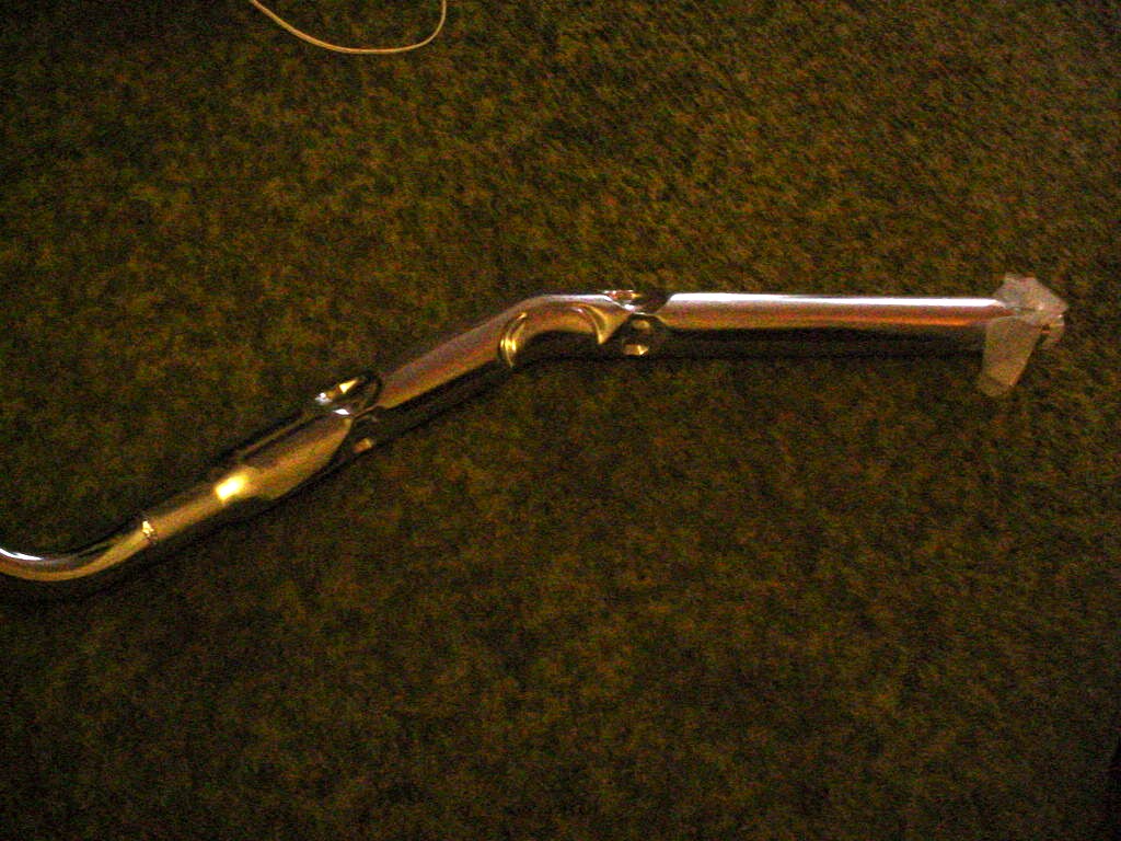

I have this pair..... believed to be Chevelle by WALKER Exhaust Co.one over the axle pipe removed. Will forward # stamping on pipes next.

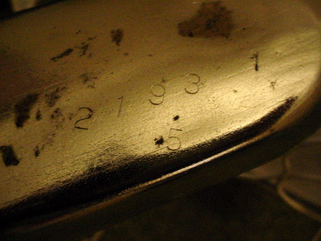

I have a NOS Walker chambered pipe stamped with the 2193 1 with a 5 below it. That pipe is from a Walker display they gave to auto parts stores in 1964. This particular pipe is the rear half for a chambered conversion set-up made for 1960 thru 1963 full size Fords, with all engines, six cylinder thru 352 (except convertible and station wagon. There is no mention whether or not it will fit a 390. Walker sold this pipe under their number CP2-5.

picture 2

another

Final picture. This is in approximately the same position as the picture above that shows the over the axle pipe attached.

Awesome info guys! Looks like I have some Walker pipes here.
Application is possibly still Chevelle ?
Everyone's insight is greatly appreciated. I'd love to find a new home for these pipes but without knowing what they fit makes it tough to advertise them.

Based on the info provided above by John Brown you have Walker chambered exhaust pipes for 1960 thru 1963 full size Fords, with all engines, six cylinder thru 352 (except convertible and station wagon) part number CP2-5. You just don't have the pipe attached to his for over the axle. I did a google search for the part number and found nothing, maybe you could locate a vintage walker catalog and it might have more info that would help with application and description. I'm sure you could use them on many applications as long as you have the space under the car and depending on the angles of the pipe. good luck with them.
