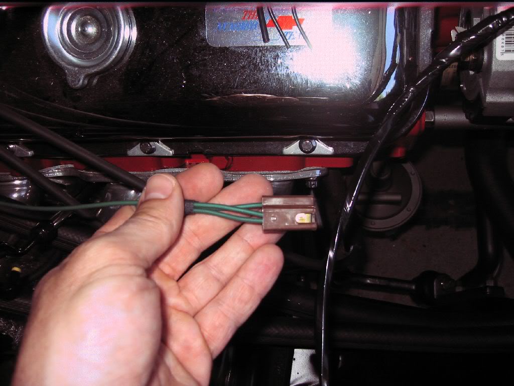

Old 04-04-2016, 04:38 PM
Posts: 21,017
Thanked 3,726 Times in 1,499 Posts
Default Re: Nova L78 with Holley 4557 - vacuum lines
<div class="ubbcode-block"><div class="ubbcode-header">Originally Posted By: [email protected]</div><div class="ubbcode-body">Put a set of headers on that bad boy and re-curve the distributor then you will not have to worry about all that other junk. </div></div>
I wish to buy all your &quot;junk&quot; Samula.
Don
Look for a green passenger side TCS terminal wire plug too,like this.
  #20
Old 04-05-2016, 12:26 AM
Diamond_Don Diamond_Don is offline
Join Date: Nov 2015
Location: Vancouver, Canada
Posts: 99
Thanks: 24
Thanked 33 Times in 18 Posts
Yes, it's there. The car is a 04A build date, so it sounds like it's just on the cusp of the production change from the all rubber hoses over to the metal connector pieces. It's great that members are able to share pictures like those in this thread, because now I'll be able to use them to source the parts and complete the set-up!
Thanks to all the sYc members who keep passing the old knowledge down the line.
