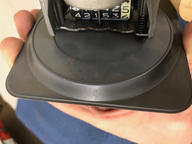

In Brent's pic, could the blurriness of the photo be a distortion from being taken through the plastic lense giving the 'grainy' appearance of the gauge where actually its as flat as the others pictured ?
I took two pics of a speedo Behind plastic and one loose.......the face of the black does look distinctly different.......
Looking at all the other info....I'd say Now, Its a Real One.....
Me bad.....
The early reproduction vinyls sure look fuzzy and not flat....
Acrylic lenses are a bit wavey........
