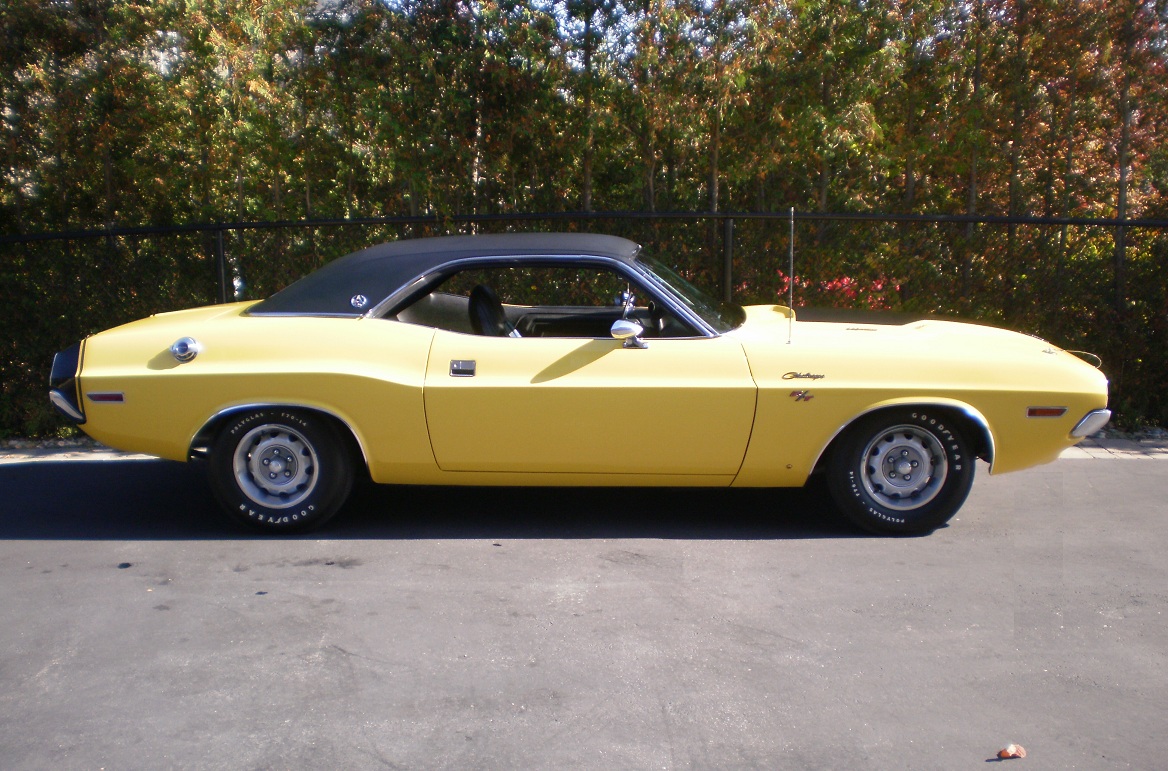

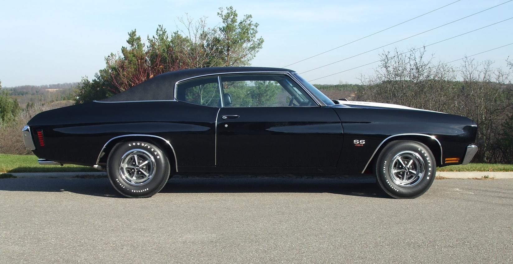

I have a set of BFG Radial TA's on my restored 71 Torino GT and was thinking of popping for a set of Goodyear Polygas GT's in F60-15's. How bad of a decision is this? Everyone says it will handle and wander really bad as compared to the BFG's. Its going to be a show/cruise night weekend car. Give me some opinions, please
