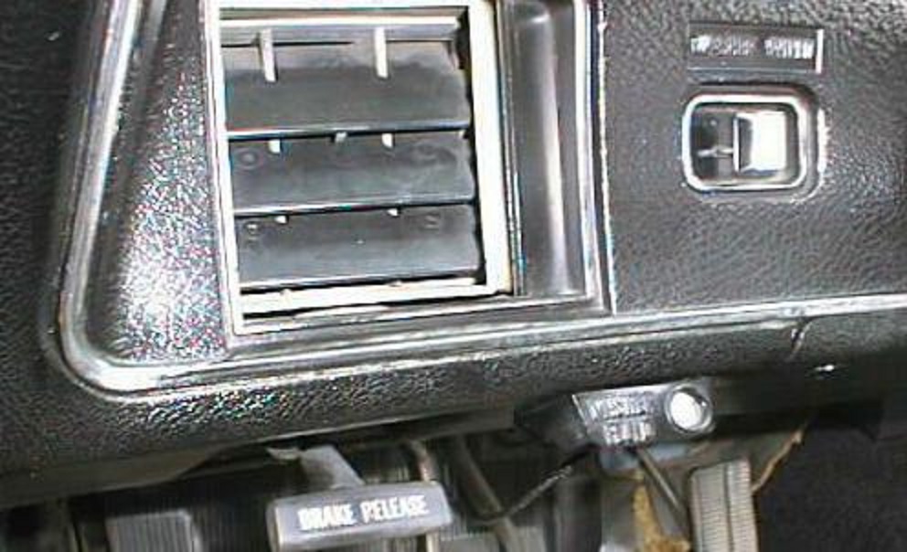

I use to restore a lot of these when I still had my parts company. You can source the float from a craft company. Find a dense material similar and cut the float. Find something to use like a hole saw. You can cut a square shape and sand it also. The shaft can be made from a plastic rod. Get creative. Use a tree from a model car kit, a swizzle stick... Ect. You'll need to plastic weld a flat piece to the top and add the color with translucent paint. It's not too dificult, you have the hard part done, you have someting to copy.

Thanks for your opinion,
I did manage to fix it and it actually works now.
I glued the 2 pieces back together and found a small piece of plastic that I had from a Pertronix kit (Used for spacing the magnet) Lucky I kept this spacer all these years. I shaped it and cut it like the original and the red paint is my wife's Nail polish and green paint I had in the garage. The glue I used is called &quot;The LAST GLUE&quot; I have repaired a lot of plastics with this stuff including dash parts, it works great. [img]<<GRAEMLIN_URL>>/biggthumpup.gif[/img]

Improvise, adapt and overcome! Now make sure your washer fluid does not freeze.
