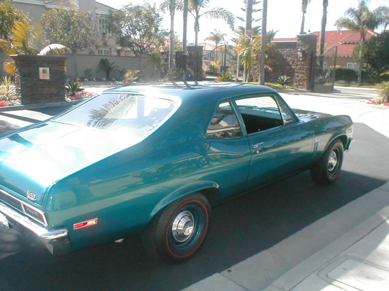

I am just wanting a good sounding exhaust system that is stock in appearance but with headers, x-pipe going into a crossflow or transverse muffler and exiting in stock location(67-8) on a BBC Camaro. No true duals.. It can be either 2.5"in / 2.5"out or 3"in / 2.5"out. So tell me what you have or what you have heard? I am leaning towards one muffler but I havent heard it in person yet. If you happen to have sound bites load them up as well.
