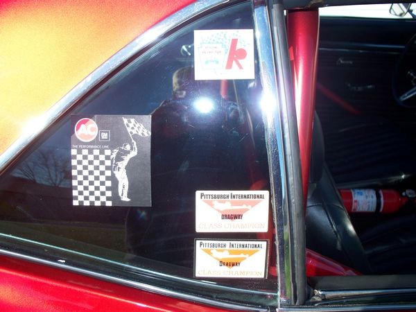

My Camaro has that AC performance logo on the quarter window!

A tough decal to get!
