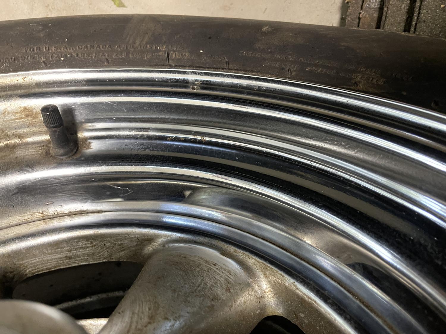

For anyone interested the price is $225.00 per wheel. The center section of the wheel has to be removed from the rim, with each piece plated separately and then reasembled. The process of separating the 2 pieces can be tricky (especially on corroded wheels) and the center can be destroyed. The turn a round is 6-8 weeks.
