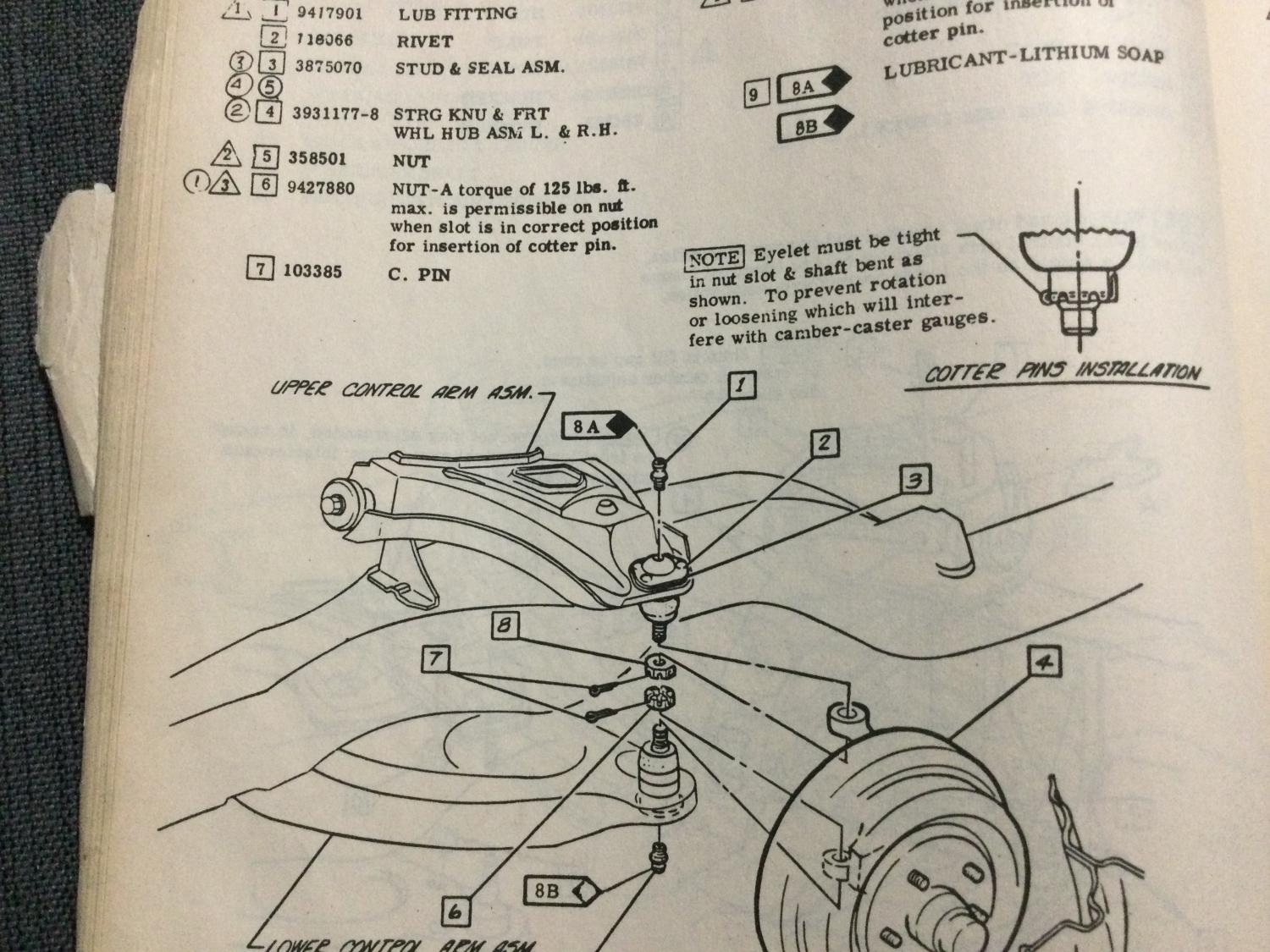

69 camaro front disc brake spindles..they look the same is there a rt and lft ? How to tell the difference?
