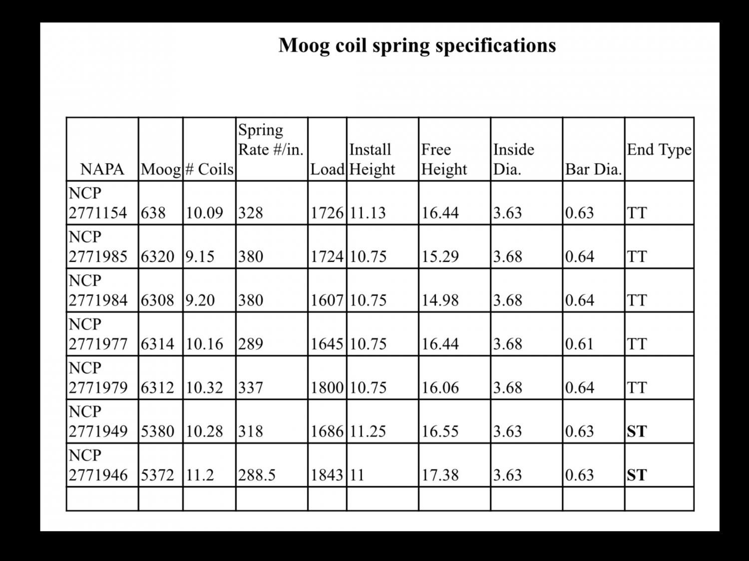

I need the best available 69 z28 front coil springs that have the correct ride height etc
Thanks
