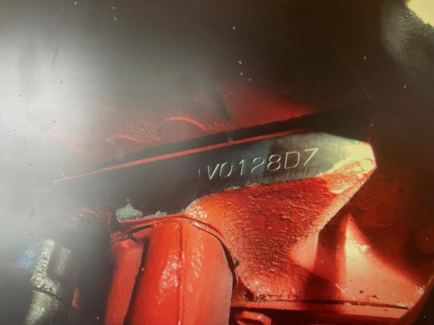

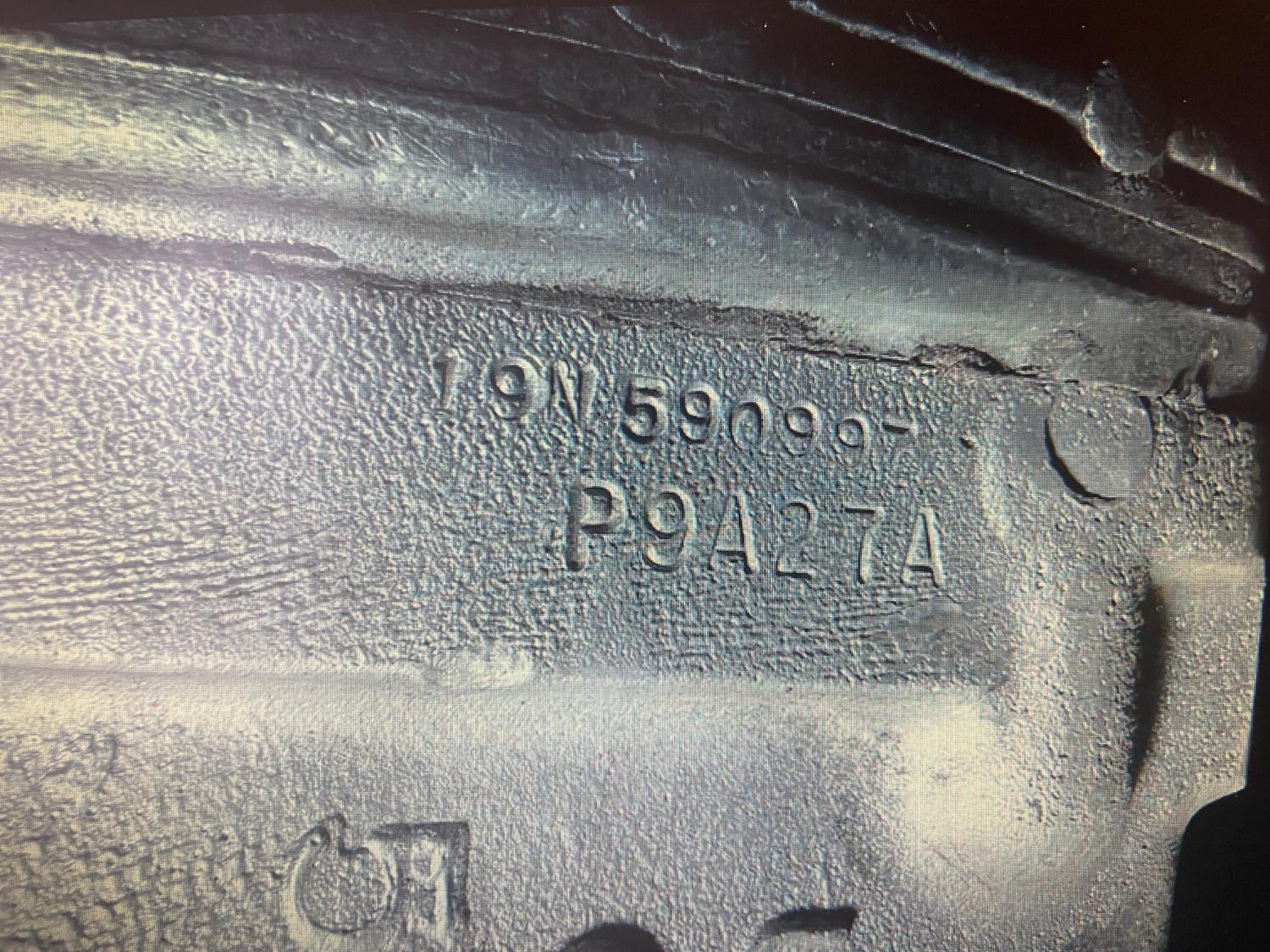

https://www.ebay.com/itm/334748526540
124379N590997
Watch the video.
Ad text does not claim the engine is original to the car, but implies it is. The V0128DZ stamping does not compare to other known original stampings. Trans stamps look ok, rear axle stamp has leading C and has clearly been altered.
Restored in non-original paint/trim.
