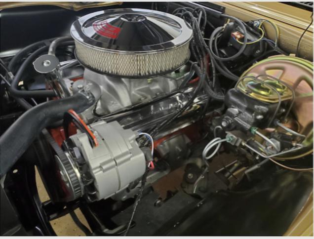

Hopefully this is an easy one but I suspect not, anyway....when I bought my 67 Z last year, it appeared to have some original paint still on it. One of those areas is where the firewall semi-gloss black ends at the top and transitions to body color. It's a Norwood car and it appears the line was masked. The Harry Mann 68 SS built in LA also has a masked line. Where the confusion comes in (for me at least) is a well-respected restorer here in Michigan seems to blow-in the transition, even spraying body color on the trim tag. If you look at a couple 67 Zs on the Heartbeat City website, you can see evidence of this. I understand that depending on the day or shift, plant workers on the same job may have done things differently but it appears the norm was a masked line perhaps specified by Fisher Body. Can anyone shed some additional light on this?
