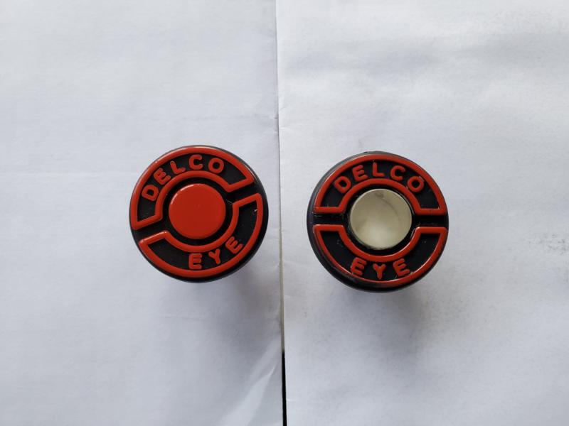

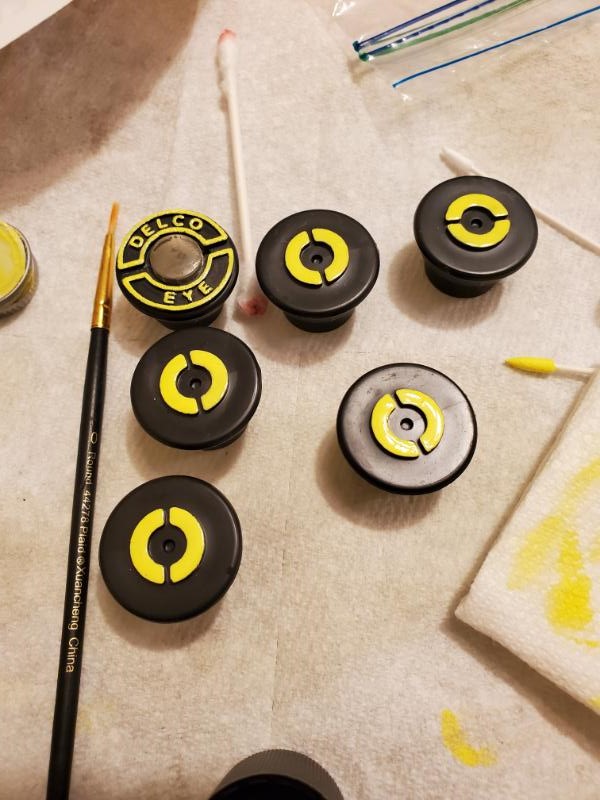

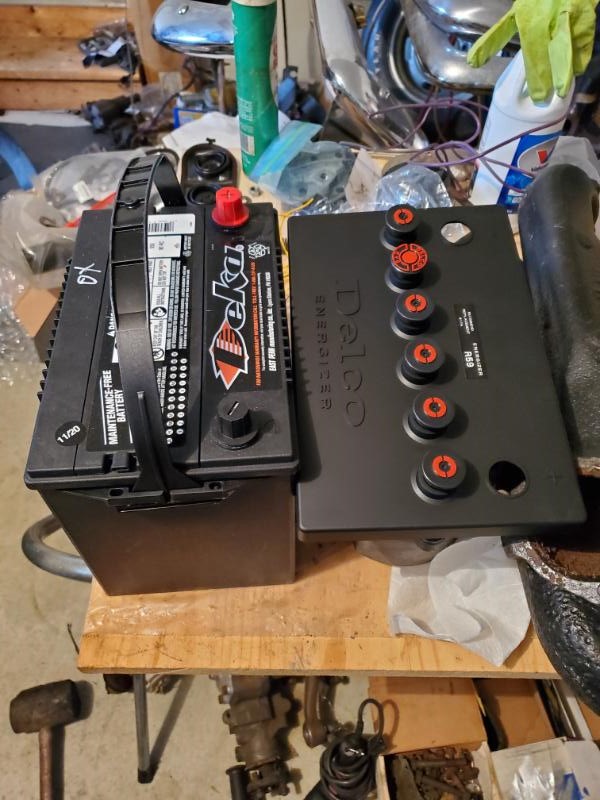

I just finished making my repop version of the Y55 battery today. I had made one just over a year ago for my 68 Z28.
It looks pretty good and started with a R59 Topper, so I had to flip flop the + and the - on the topper for the Y55 battery has the reverse polarity. The positive is on the fender side vs the radiator side.
Had to re-paint the caps yellow and drill the center of the lettered cap to install a glass eye as the originals.
