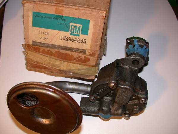

GM literature lists oil pump c/w pick up - GM #3946023 used with 427 GM Deep Performance Oil Pan, 6 quart - GM #3879633. Other GM publications list oil pump c/w pick up - GM #3964255 used with 427 GM Deep Performance Oil Pan, 6 quart - GM #3879633
It is my understanding that oil pump - GM #3964255 came with the pick up that was not spot welded to the pump, allowing for optimum adjustment. Whereas the GM #3946023 came from GM already adjusted and tack welded.
Can anyone confirm?
Thanks!
