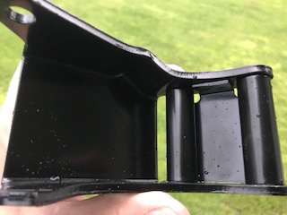

Here's my review of a reproduction CHQ GM licensed 67-68 SS350, Z-28 PS bracket.
It looks nice but the bolt tubes are attached with 2 tiny spot welds shown on upper tab in pic. I can move that piece around with my fingers.
Some re-welding on the tubes is in order here to fix this.
In the meantime I will keep searching for an original while I contemplate returning the repro or fixing it. Too bad as I have every other pulley and bracket nos for the SS350.
