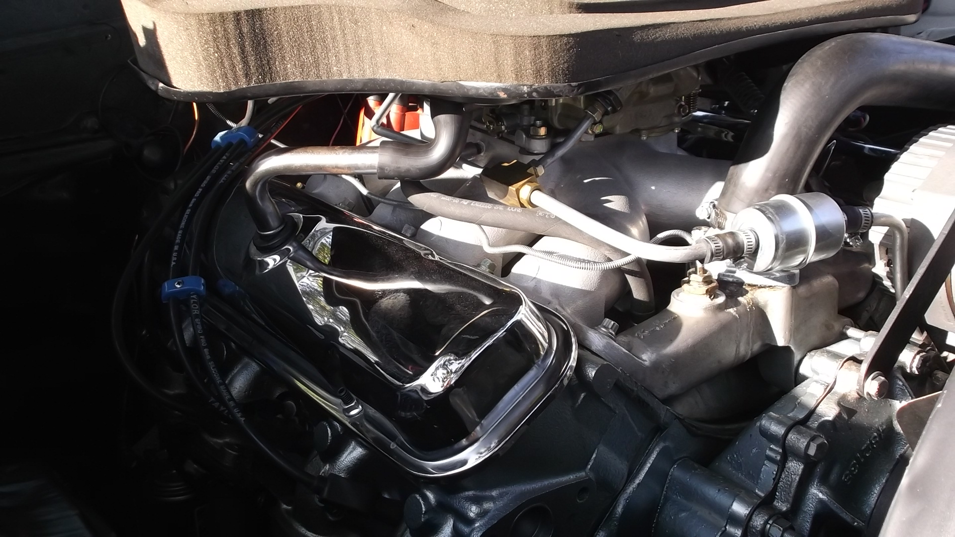

Just built a very rare 366 NASCAR RA V engine for my 69 bird.Just got it off Joe Shermans dyno.Ran it with a single 4bbl carb as it will be put in the car and a 2-4 intake with a pair of small AFBs.With the duals it made 452 HP @6700.True 9.5 CR calif pump gas engine.Will post a vid.Tom
