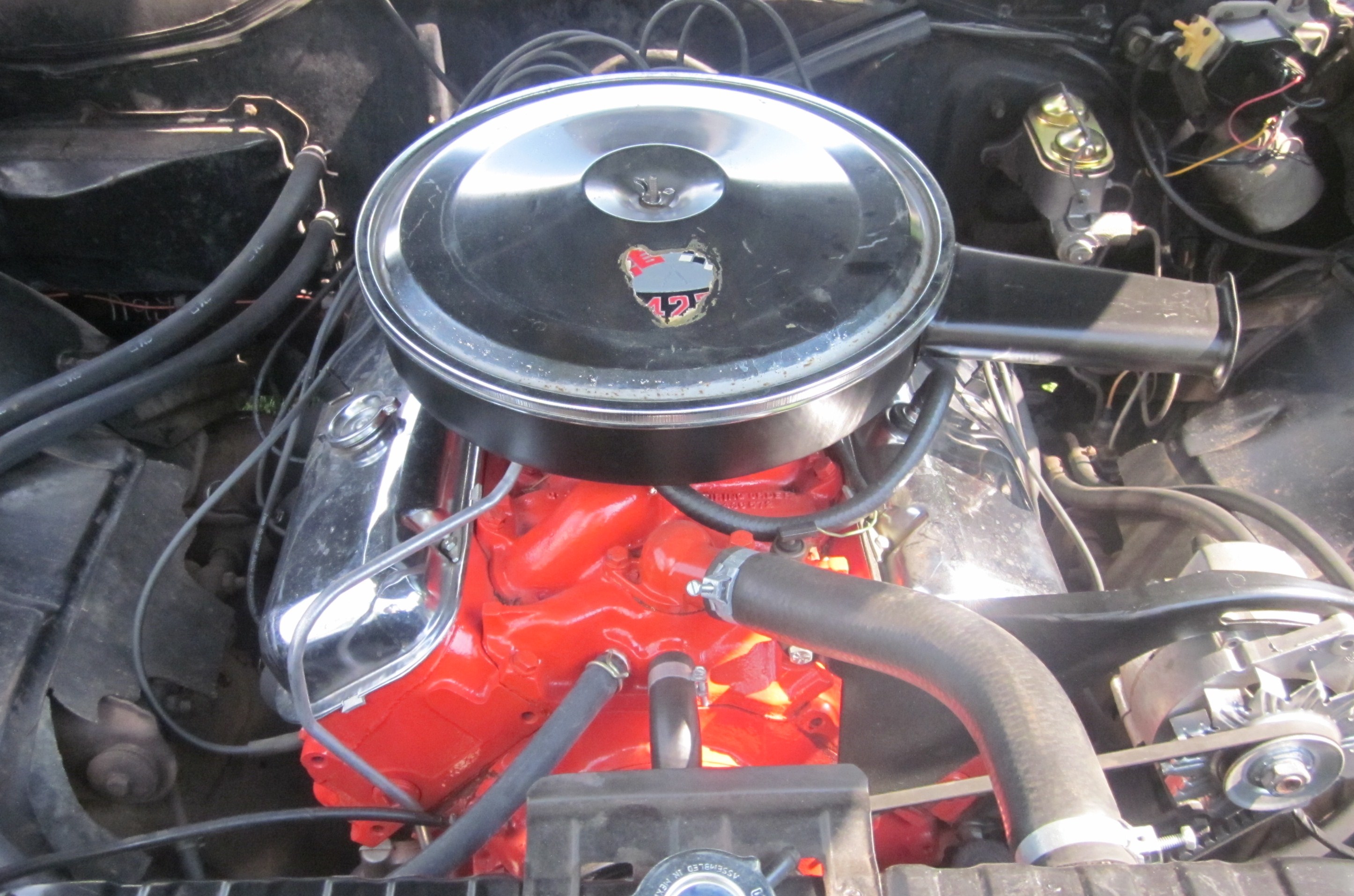

well im going thru my 427 in my 67 impala,the original owner rebuilt in the late 80's using l2268 pistons and the original heads,just a tad bit too much compression! im lookin at the l2300f with .140 dome.im thinking this will get me back close to my original 10.25 to 1. will these work with my original closed chamber heads? ive thought of using keith blacks,as i just finished building a 66 396/325 and had issues with the speedpro repalcements hittin my heads
