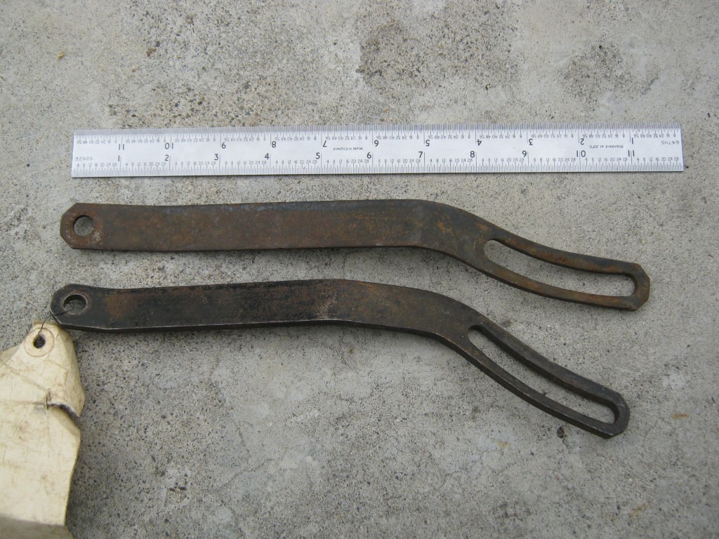

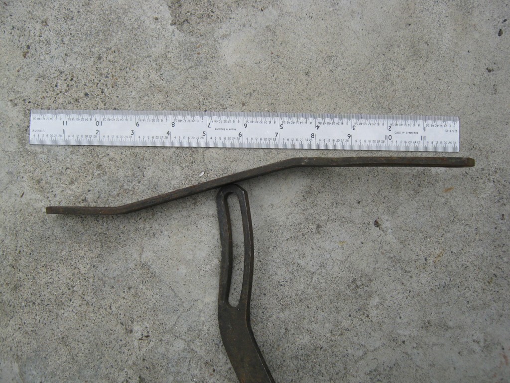

I found what I think is the correct 68 BB smog pump adjuster brace. It is about 11 3/16” long, measured along the straight edge to the curved tip. The offset bend is about 1 5/16” from the mounting hole flat section to the slotted section. It also has a “B” stamping on it. The attached image shows a mark a little to the right of the bend near the hole. That’s where the “B” is on mine. Anyone have an original to check these measurements with? The slot is at a different angle than a small block brace. The brace with the tag is a 68 SB.
