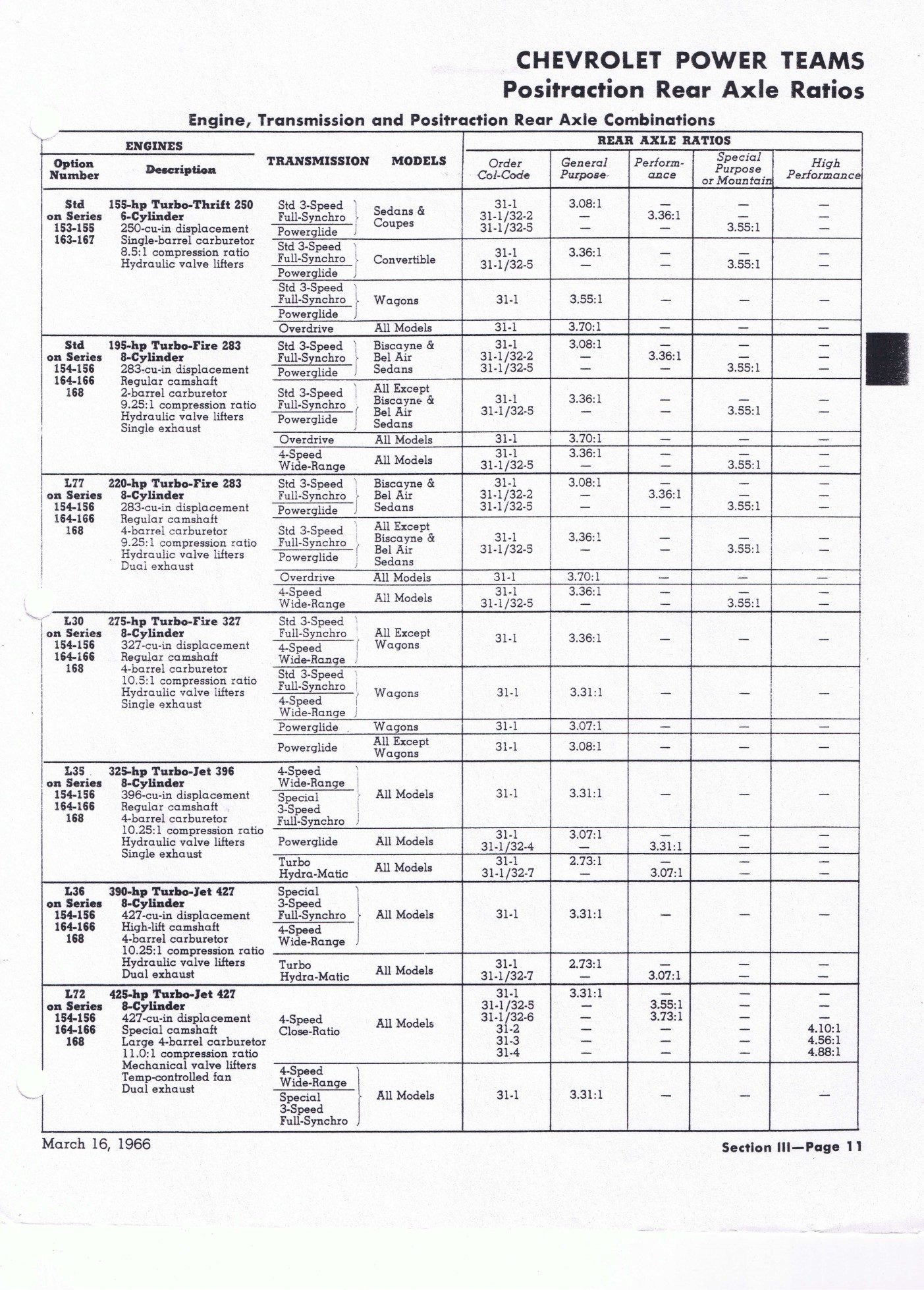

Default See attached
Price and facts book 3rd edition, Re; Tach and Trans info
Power Team Chart:
