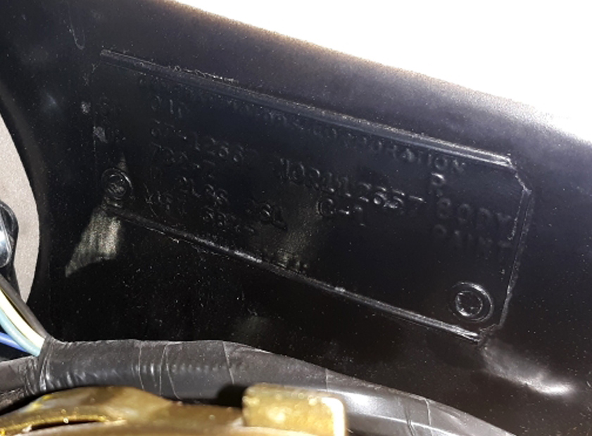

124677N213280 - BODY#112657 - 67 Camaro L78 Pace Car Converitble -

I went and looked the car over about a month ago, unfortunately my SD card was damaged prior to downloading and the smartphone photos I have are terrible.
Best photo of cowl tag I have is attached.

THE GOOD...
REAL L78 PACER - my opinion is the tags do not appear to have ever been removed from the car.
The engine is a 67 L78 T0413MQ with a sister car's VIN -7N212xxx which is from a very close car and theoretically could have come in this car. The last 3 vin digits have too much paint to make out.
Fresh restoration... of what appears to have been a solid rust free car - appearance is very nice and the fit/finish is better than new- body panels/floor pans etc show no signs of rust pitting etc.
Well optioned - 04C, L78, M21, RS, tinted windshield only, rear bumper guards, remote mirror, deluxe seat belts (all), console, equipped with tilt as well. and the - (dash) in the 5 group.
I told the they should obtain a NCRS shipping report and remove the paint from the broach pad with paint stripper or lacquer thinner... and DO NOT USE ANY ABRASIVES - they may get the shipping report - doubt they will remove the paint.
