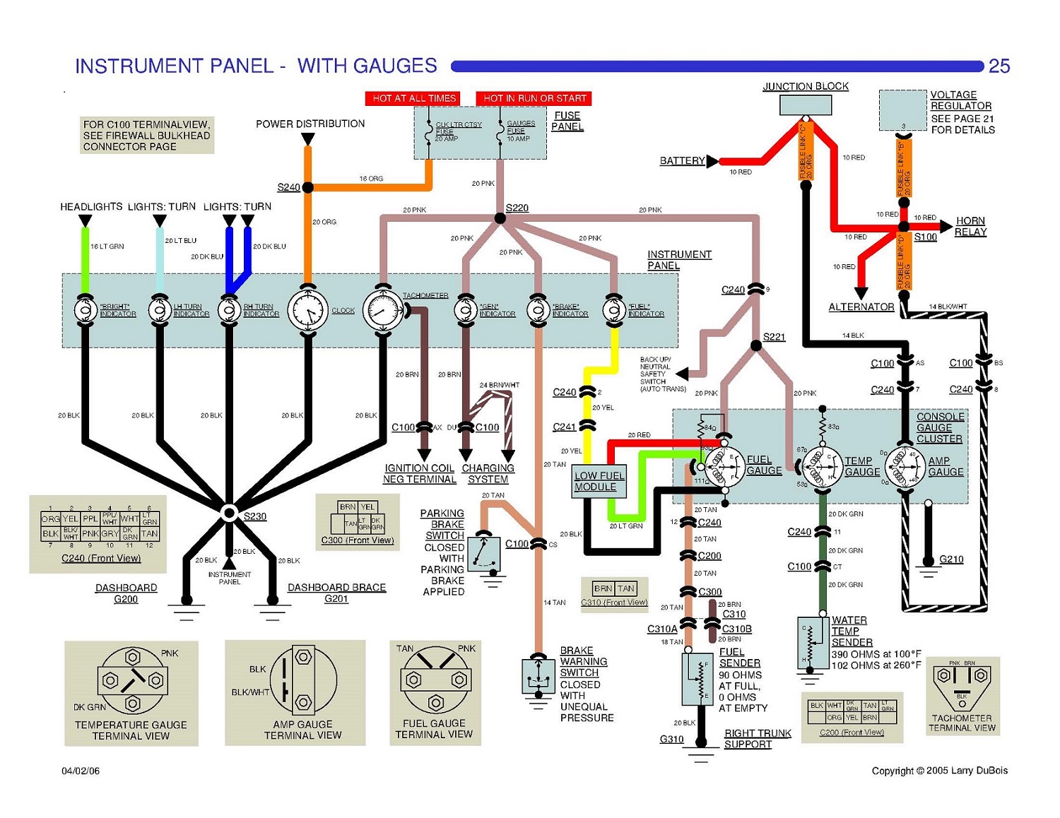

Does any one have a dash wiring diagrams for the low fuel light? I have a console with gauges , low fuel light sender. Does the yellow wire run up to the light socket? If so what wire is on the other side of light socket.
Any help would be appreciated.
Todd
