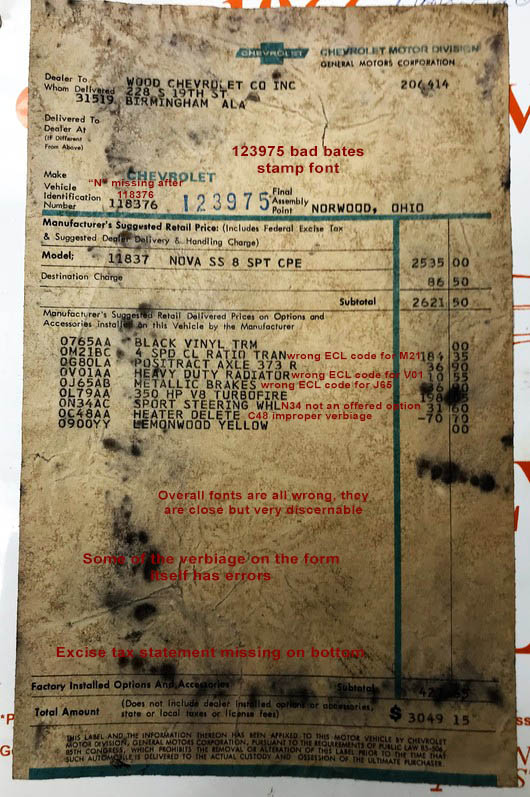

Default 1966 Nova L79 on Mecum
Nice looking car but once again claiming that the window sticker is original....
Paperwork on bottom of page:
https://www.mecum.com/lots/FL0118-31...olet-nova-l79/
Paul
[email protected]
Attachments - The Supercar Registry L79hor3.jpg 1966 Nova WS 123975 analysis.jpg
