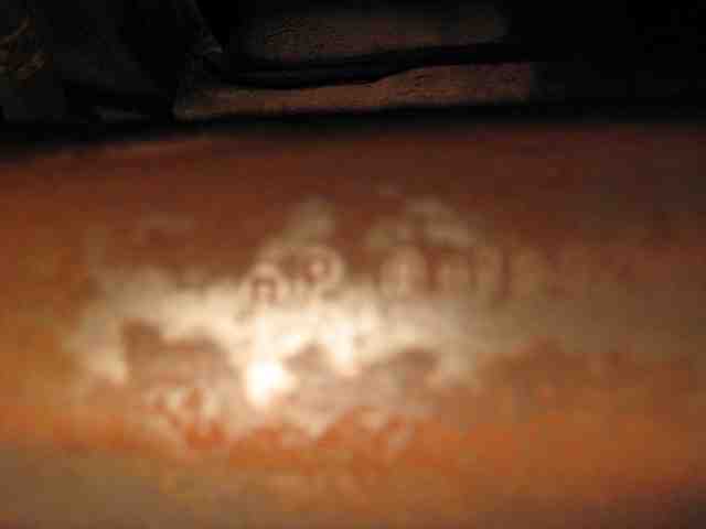

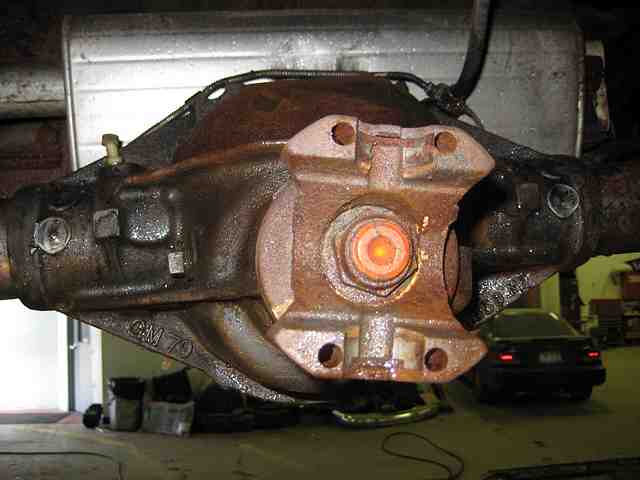

Rear axle housing assembly stamp...BP 0415 G 2
BP is 2.73 gear set April 15th Detroit Gear & Axle 2nd shift...matches POP...it's a little fuzzy.
