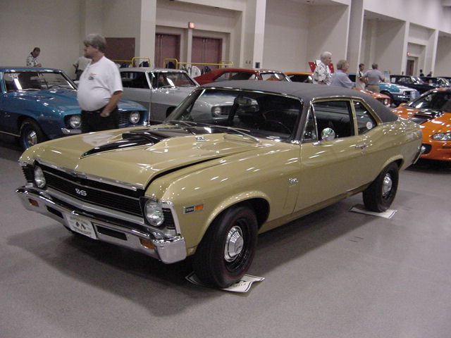

That was the general rule, but exceptions have been noted... One in particular that comes to mind is Joey Swezey's gold 69 Dana Nova. Might have just been a supply issue, ie: no wheels in the correct body color as the car was coming down the line, so they ended up with black ones instead. Just a guess.

[quote... One in particular that comes to mind is Joey Swezey's gold 69 Dana Nova. Might have just been a supply issue, ie: no wheels in the correct body color as the car was coming down the line, so they ended up with black ones instead. Just a guess.
This car? One of the finest looking Novas I've ever seen.

That may be true on Impalas, but 68 SS Camaros (car in question) did not get full wheel covers as standard equipment as part of the SS package, they got steelies with dog dishes. I still say cars that came with black wheels likely came that way because of a supply problem with having the proper color of wheels at the time of assembly... The fact that the wheel paint was totally different type of paint than the body paint makes me feel even more confident that this could have, and likely DID happen on occassion...
