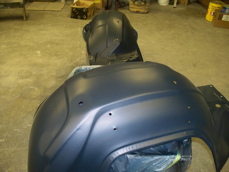

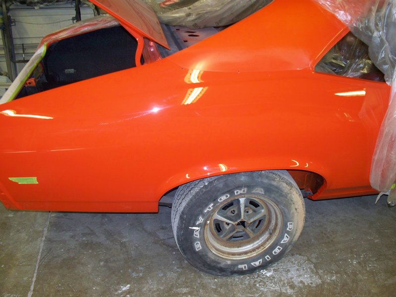

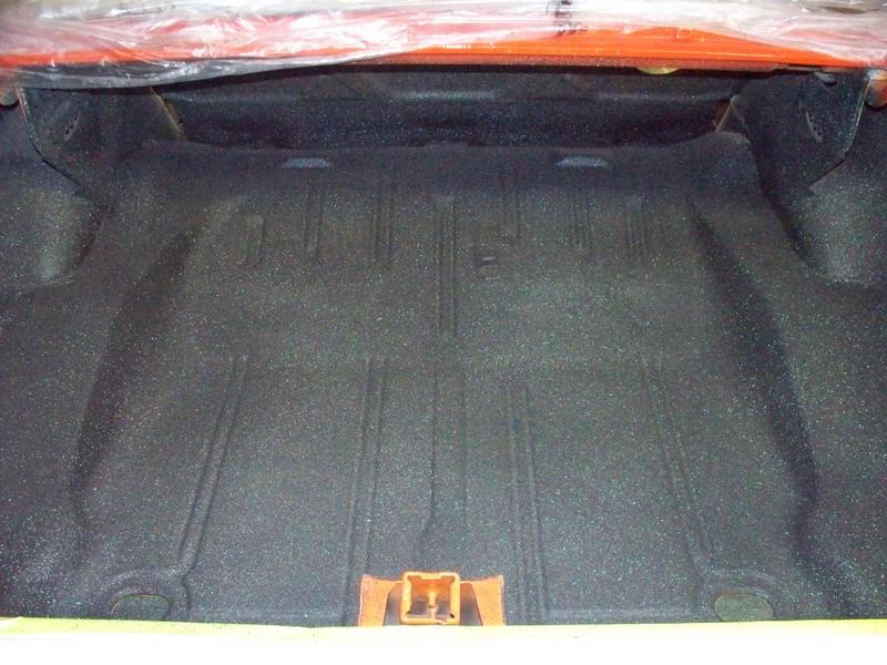

some interesting pic's of the trunk lid while at kens for restoration....
lid has paint runs and very light paint, also no paint under hinges and in front of lid area.
Attachments - The Supercar Registry 396986-tn_innerfenders1.JPG 396984-tn_firewall1.JPG 396983-tn_trunk1.JPG 396982-tn_paintcar17.JPG
