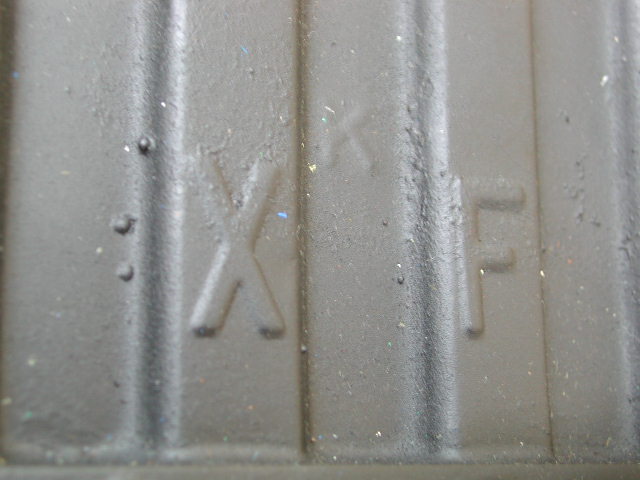

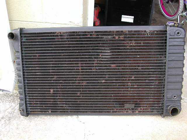

Her are some pics of my tank codes and tag.

I have an original XF, I was told was for an LS6 with A/T and 4:10 gears. Is this correct?
How much is it worth? I'm interested in selling it.
