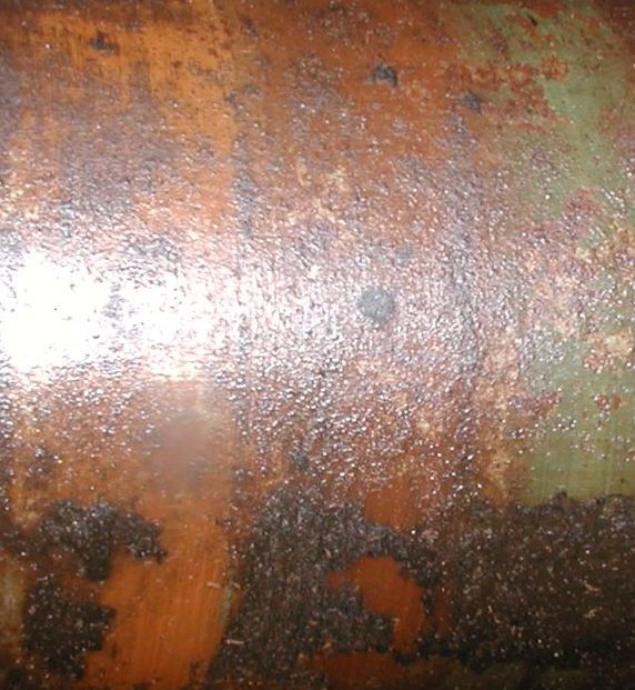

Do you know what the stripe color combinations for these 3 driveshafts would be?
Here is a 69 nova L78 4spd...hope it helps.
wilma

What colors are we lookin at, hard to tell from that shot.
Thanks Mike

Looked at the original photo...too large to post..left to right: orange/red/green
I can email the photo to anyone who wants it...just drop me anote at [email protected]
I think also have a BB th400 pic showing the stripes...
wilma
