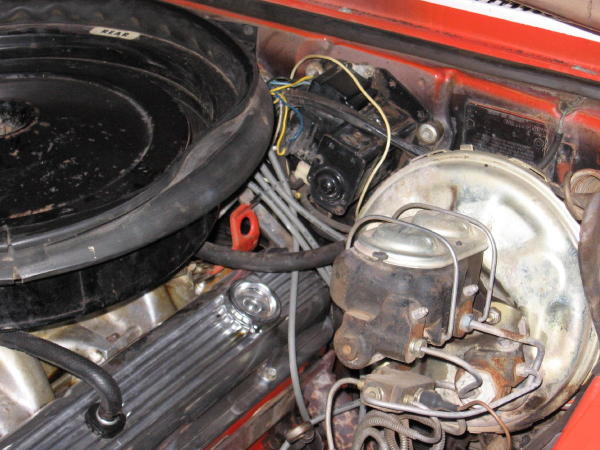

The round metering valve is attached to a small bracket that attaches to the outside stud the master attaches to. The valve is located to the left (drivers left)of the distribution block , and slightly up from the block. I think a picture would explain it much better. I will look for a pic later.
www.vintagecertification.com

Attached is a pic of the metering valve location. This pic is from a survivor Z we will be certifying thru Vintage Camaro at the Camaro Nationals @ Carlisle this year.

Default Re: 1969 power brake metering valve location
The above pic Stefano posted is of the pressure regulator (located on the drivers side subframe under door area) usage was primarily used on all disc brake cars, although for some reason some drum brake cars as well. The use is kind of a mystery because it was not used in the beginning of 69 and reintroduce in mid 69.
