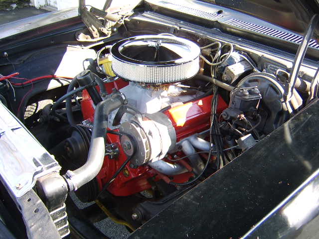

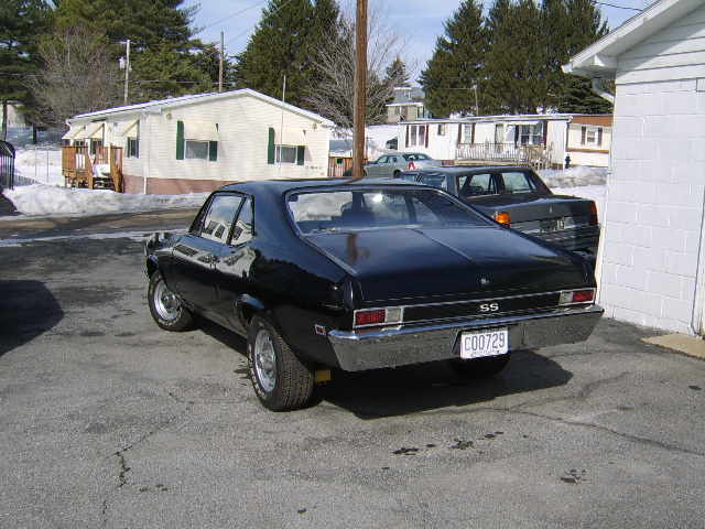

Here are some pics he sent to me. Hope they come through. He said someone changed out the front buckets and the build sheet was gone. I always thought it could be under the back seat somewhere or even between the trunk floor and gas tank. Am I wrong?

Build sheet won't be on top of the tank...check both top and bottom of the back seat and look carefully in the padding....my 68 had it's build sheet hidden by a prior seat recovering job....exterior shots seem to show all the usual SS badging...check those front discs..are they 4 piston calipers..?? look for original exhaust hanger on drivers side rear for the factory dual exhaust...hanger comes down from floor...tailpipe has bracket on frame rail...rare to see dual exhaust on a non-SS car of that vintage...what is the redline on the tach..??? more photos of interior...Nova SS emblem on dash pad..???
