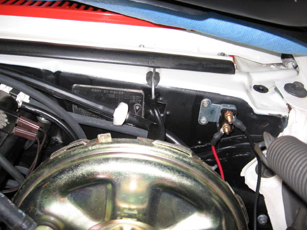

PW don't go thru the fuse panel, there is a 20A breaker mounted on the firewall to the right (as your looking at it) of the master cylinder that powers the PW setup. That breaker is directly connected to the horn relay terminal where the charge wire (red #12 wire to battery + terminal) is located.
Same with the power top.

Here are a few angles of my fuse box, 69RS pwr top, pwr windows:
Hope these help, give me a call at 850-543-0221 this evening and I can try to talk you thru it, I hate electrical gremlins too. All my stuff works and I haven't changed any of the wires in question so I assume they are original. While taking the pics I noticed a 20a fuse was blown, replaced it so don't anyone get on me about that.
