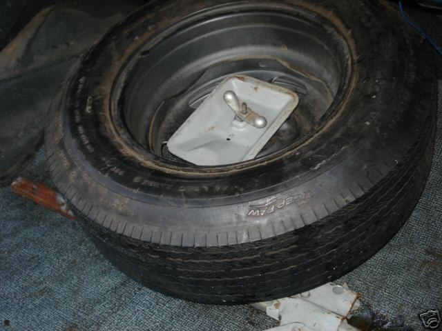

were the ralley wheels standard equip on the ss in 69 as my invoice dosen,t show them??

1969 SS Nova came standard with the 14 x 7 XT wheel/dog dish caps...wheels were painted body color....Rally wheels(YJ) and SS 5 spoke(YA) were optional....redline E70 x 14 wide-ovals were the std. tires...whitelines were the upgrade.

This car came standard with the uniroyal tiger paw red lines with 14x7 rallies but i don,t see where they itemized the ralley wheels like all the other options on the dealer invoice..unless they were dealer switched out at time of delivery including the orig spare and rim.

Scott, check the dates and codes on the wheels and see how the line up.....if they fit with the build date of the car they may be original..the rallys were definately an optional wheel..the Tiger Paws would have been the OEM tire...could be dealer installed??? hard to say..the spare is a rally also??? how about some photos...

yes all the build dates line up and the spare is also orig and never removed see pic..its basically the same spare tire(tiger paw) as my deuce except it has a white wall...
