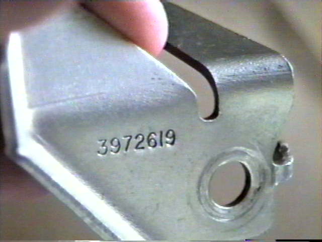

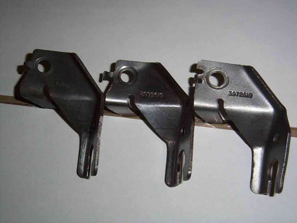

I have seen information re the accelerator brackets for the
70 chevelle recently that in my opinion is not correct. So in an effort to clear up the matter here are a few pics of the real ones.LS6 brackerts.
Peter

this one is a l78 bracket

I found your post about the differences very interesting! I just went out and checked the accelerator/throttle cable brackets on my 2 1971 LS-6 Corvettes, they use the example that you posted as a L78 bracket.
2 1971 LS-6 Corvette coupes (Duntov's last stand)

I found 6 original l78 brackets on 70 chevelles with build dates from sept to Nov 69 all had L78 brackets.
I also found about 11 brackets on ls6 Cars to be the same
ones.I never found one L78 bracket on a car built after
Dec 1 1969. I also found that the LS6 bracket on 70 Nova
built april 1970. Which would be consistant.
It does sugest that the L78 Bracket could of been the first design and was later modified because I beleive they were having trouble with the die that stamped them out and went to a simpler die design. One of those brackets shows signs of many die repairs. However there maybe cars built after
Dec 1/69 that were fitted with the L78 brackets???
Everytime I see a 70 LS6 car or a L78 car I ask the owner to check the bracket. YOurs is the first one I have run across so far with the L78 Bracket.
Peter

I received a few emails asking about the real 619 brackets
vs the repops
Peter

Here is another pic
Peter

If your car was built after Dec/1969 then it would probably
have use what I call the ls6 bracket in the pics.
I found an april 1970 l78 Nova and it had this bracket on
the intake.
Peter

Am I missing something? All look the same and all have the same part number. What's the difference between the brackets you posted??
