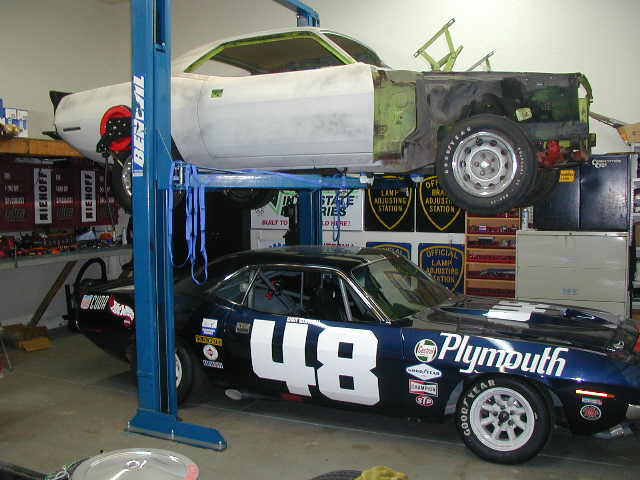

I am looking into buying an auto lift (probably 4 post) for my future garage. I plan on using the lift to store one of my Camaros & also give me the ability to do underbody detailing & some light maintenance to them.
I have done some Internet searching to see what's all out there for auto lifts. And boy, there are quite a few companies & models to choose from.
Any advice (do's, don'ts, recommended brands, etc) & info that anyone on this board can share with me on auto lifts would be greatly appreciated.
