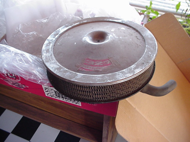

Old 05-12-2006, 02:16 AM
Join Date: Jun 2000
Posts: 4,411
Thanked 30 Times in 18 Posts
Default Re: Opinions on this Block Stamp
Here is a org air cleaner from a 68 l-79 Chevelle
