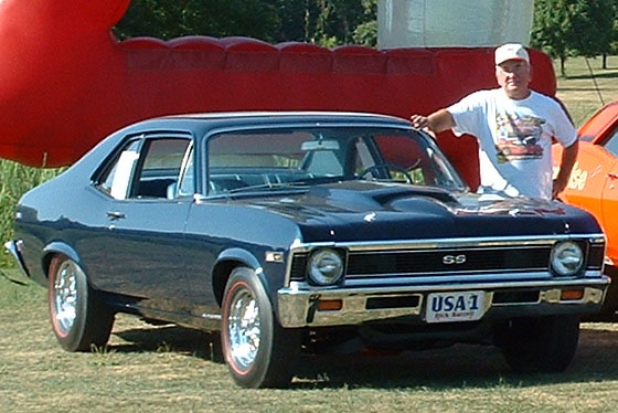

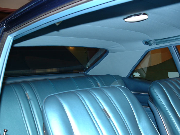

Default Re: interior paint question
Schonyenko2;
I got a great shot of Ray M's from last years nationals. I generally do not take pictures of the packtray. But this is a 3/4 exterior shot that clearly shows the rear window metal as interior blue.
Greg R.

Greg, I have A "B" on the trim tag. Schonye, I have blue paint around the speaker holes but haven't gotten under the paint at the rear window yet. I am trying to post the PPG paint info for 68. I forgot I had it, maybe it will help some.
Tommy
Old 05-09-2006, 10:25 AM
Tommy Tommy is offline
Join Date: Nov 2001
Posts: 1,673
Thanks: 88
Thanked 98 Times in 44 Posts
I know thats not a very clear scan, sorry. Looks like 737 is listed twice both times being dark blue poly, once in A low gloss and the other "0" gloss. Looks like my dash uses both low and zero gloss and from what I can tell the area in question at the rear window is also blue "0" gloss.
