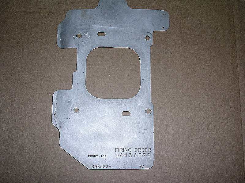

Somewhere there was a post...What is the 3 ?

The 1970 Z/28 w/NA-9 is Heat shield #3972156.

My NOR Z has a 3969835 plate. Wrong one?

Part #3969835 is for ALL 1970 NA-9 Vehicles w/L-78 & LS-6 engines.

Charley, did you find a 2156 shield?

Charley..In your travels, if you run across the 2156, I have a NOS and a used 835 that I would be more than happy to trade both of them for the 2156. Your friend that I bought the 70 Z28 timing cover from has me on his list if he ever finds one.
