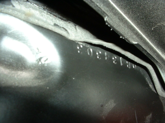

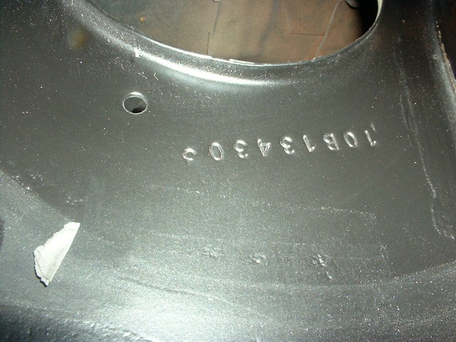

I was looking at some partial VIN stampings and it sure looks like the partial VIN on the engine is also the exact same stamp used on the hidden VIN's on the body. Is this a known fact? I know the transmission VIN and engine VIN should be the exact same stamp but I wasn't sure if the engine/trans stamp would match the hidden VIN as well.

I know the sequence is the same but I'm wondering if they physically used the same gang stamp to hit all the areas that needed the partial VIN. So if there was something odd about one of the digits it would look exactly the same on all the stamps(ie they used an "I" instead of a "1"). So would they stamp the engine/trans and then hit the top of the cowl and firewall by the heater box all with the same stamp before changing the gang stamp for the next car?

JohnZ could certainly give us a definitive answer on this, but I will go out on a limb and say the two body stamps were from the same unit. However, the partial VIN on engine and trans were a smaller font, so could not be the same. I want to say 3/16 on the body numbers and 1/8 on the engine/trans. I am almost certain JohnZ recently posted something about the body stampings on the team camaro site. It was a type of roll stamp and done by machine, not with a gang holder like engine and trans.
I just went out in the garage and looked at my body stampings and they appear identical, except the one under the blower fan is upside down. The fifth digit on mine is somewhat out of place about the same amount on both of mine.
