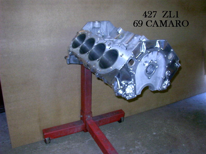

It seems that there are more 3946052 ZL1 blocks popping up on ebay every day. From what I understood there were only 69 camaro's and 2 corvette,s and maybe 18 or so over the counter motors. And how do you tell if it is a over the counter motor from one that came in a car from a can am motor? I own one that doesnt have any dates or vin #'s on it, just a cast number. Mine came from Washington state and has a history of being in that state for at least 25-30 years or so.
[image]http://www.pbase.com/paule/image/51956005[/image]
Attachments - The Supercar Registry ZL1 warranty.PNG ZL1 cast date.PNG 186275-ZL1Vette.jpg 174541-motor005.jpg

Probably not. The originals had nice sand cast dates in them. I dont know if the new ones do but if they do I dont think they'd cast in a date of 1969. Plus the new blocks are redesigned for strenght. The old blocks are really cool but Grumpy Jenkins called them "junk"

The new blocks have screw in freeze plugs, and a few other updates but they are cast from the original molds. I remember reading about when the guy found them in the Winters Foundry. Said that they were in almost perfect shape as not too many blocks were cast in relation to useful life cycle of the molds.

I do have one of those new blocks. I built a complete ZL-1 engine with ZL-1 heads,manifold,carb,distributor, and NOS Zl-1 cam,pistons,crank,rods,etc. and run it in my 69 SS Camaro. The block is outstanding quality, the engine is the same weight as a small block. The new block has the early ZL-1 casting number 3946053 and no "Winters" snowflake on the front.
