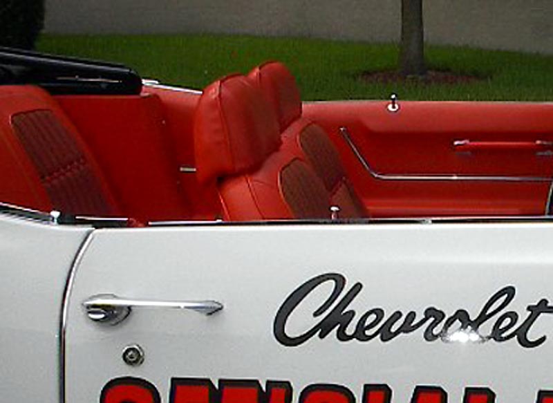

BB 396 pace car with a/c nice car. http://cgi.ebay.com/ebaymotors/ws/eBayIS...433936&rd=1

Nice car? For the big $$ they want it could have a bit more detail...
wrong master, trim rings, front seat belts, wiper arms, PCV & hose, rotors, lighter
missing AIR system, rear seat belts, a-arm seals, a/c core support seal, e-brake cable brackets, RH door wedge, fuel pedal trim
worn radio faceplate, seats
tape pinstripes & homemade exhaust, many incorrect finishes
Not my idea of an "EXTREME" #1 TRAILER SHOW CAR!!"

...and no paperwork to prove it was an original big block car.

I doubt it is a big block car originally as it still sports the small block a/c evaporator and POA valve assy. The engine side of the evaporator box looks like the repro fiberglass unit as it is a different color and finish than the half closer to the fender. Also note the junk repro headrest covers. There is no reason for any top notch car not to have the headrests restored correctly............RatPack...................... .....Forgot to mention the FORD fan decal on the shroud.................

small block tach.I don't think it's an original BB car either.

Shoudnt it also have a curved neck radiator to clear the ac?

I always wonder about a Pace Car without Custom Deluxe Seat Belts (YA1), this was a manditory option. I'm looking for a big block Pace Car.
