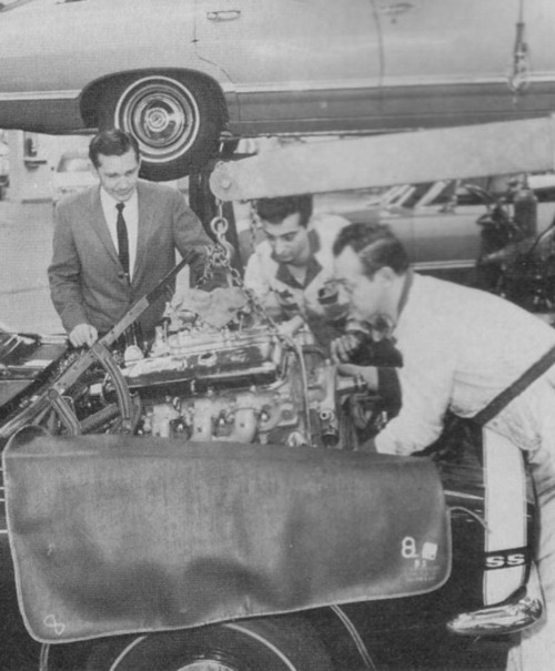

Here's another photo illustrating the base '67 caps and wheels on a '67 Camaro (not on the Impala in the background---those were different style hubcaps).
This is an early (the first?) Nickey 427 swap into a '67 Camaro with the great Dick Harrell looking on. Note that the Camaro had drum brakes, as evidenced by the body-colored steel wheels and base hubcaps. Car was delivered as an SS 350 and converted to L72 427 power.
