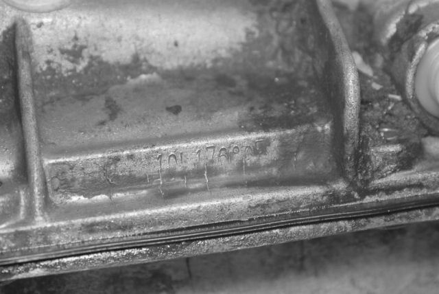

Here are some detailed pictures from a 1968 CY THM400 trans, courtesy of Tommy K and the Super Car Workshop...

VIN...
