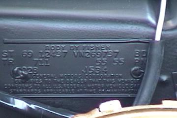

At a show this past week end saw a 69 camaro as a west coast copo????? have trim tag info see a Attachement
Attachments - The Supercar Registry 15933-Picture 028.jpg 15883-Picture 008.jpg

Did you happen to get the VIN? That would help me tell.

Sorry Kurt I did not get the vin [img]/ubbthreads/images/icons/confused.gif[/img] here is a picture

It really looks like a nice car. I wonder why it has the alternator on the wrong side and also the wrong master cylinder.

Take a look at that radiator. Seems to also look incorrect lol

The master cylinder is a NAPA or similar replacement for the disc brakes, same as on my car which is incorrect. I do not know why this car has the 67-68 alternator setup along with the 67-68 bb fan shroud. If it wasn't for the car having 69 inner fenders I would think that it was a 67 or 68 bb Camaro with a ZL2 hood & air cleaner assembly................RatPack..........

Master looks like a correct '68 Bendix unit for power drums. But can't tell for certain?

VIN is 9L523735. Was listed by last seller as a COPO clone.
