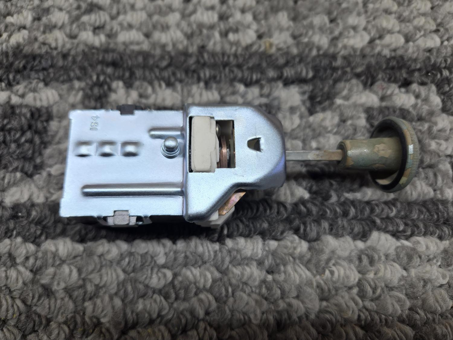

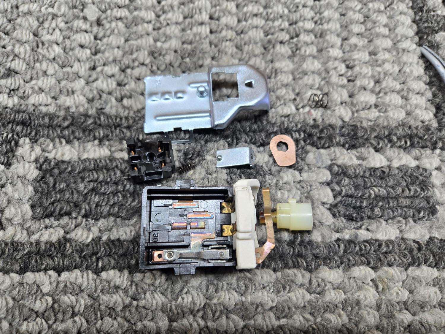

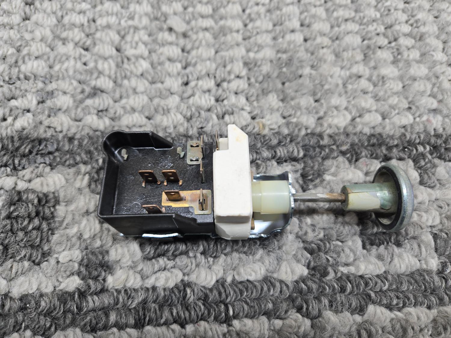

The smaller pieces are mini restorations. Just an example of pulling apart, cleaning and replating pieces of the light switch. I need to get a new repro knob as the original cannot be saved.

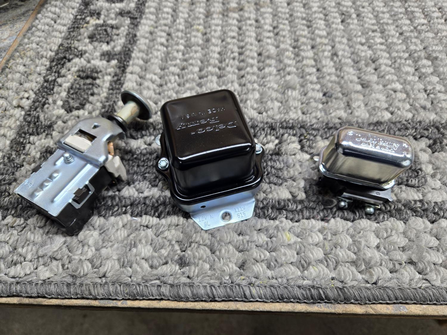

If Dave and Dan Schutzbank ever come past this post, the last few pictures are for them. Ive been selling dated voltage regulators for a long time and always told them i could not do do factory plating. I finally have the means to do it and the results are pretty solid. I run the regulator on a old school regulator testor. Always good to readjust once its in the car. Even the horn relay cover is near chrome finish quality with zinc plating.
