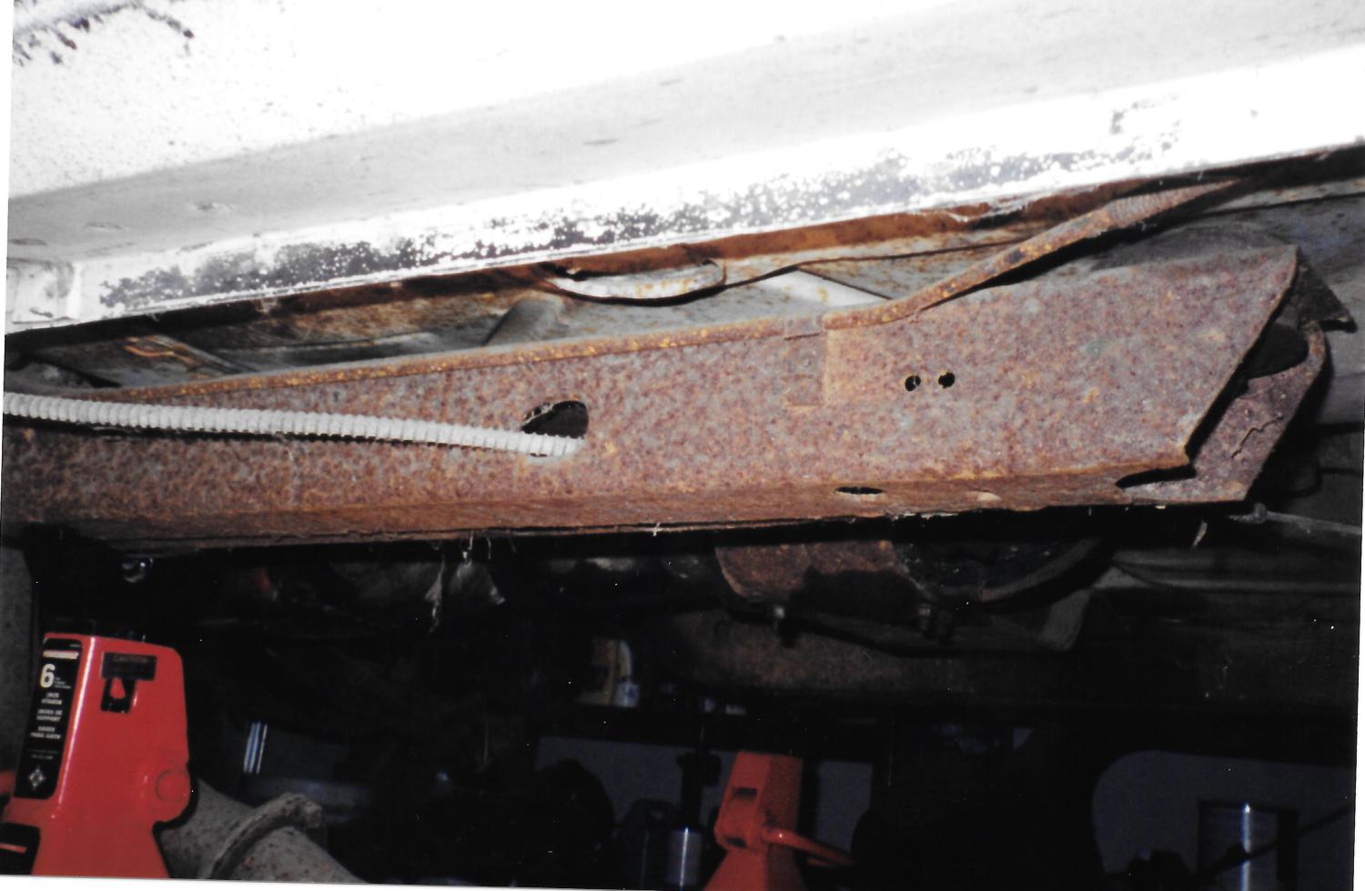

do all 1969 Z-28's have the brake pressure valve on drivers side frame rail?
