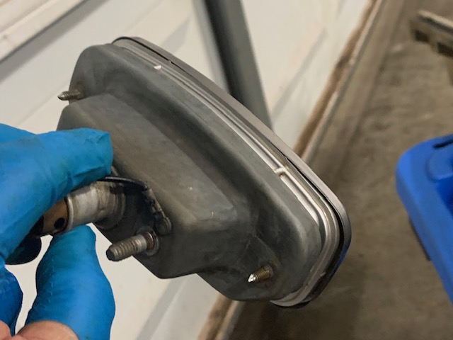

where the parking light housings gold or silver zinc plated
Attachments - The Supercar Registry Reference Park Lamp 3.jpeg Reference Park Lamp 2.jpeg Reference Park Lamp 1.jpeg

1968
STD Grill Park-Turn/Steel Housing/Galv.
Photo Credit "Joe" >?

is there anyone that does the galvanizing process

^^^ That is the Difficult Question.
I Never found a source in my area, So I just Brite Zinc plated many parts the "Should" be Galv. There is a Thread discussing this here recently also.
