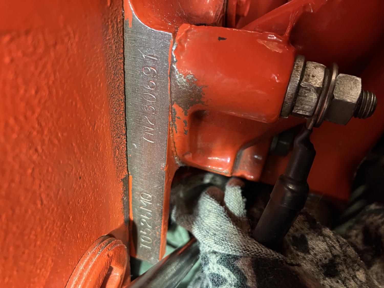

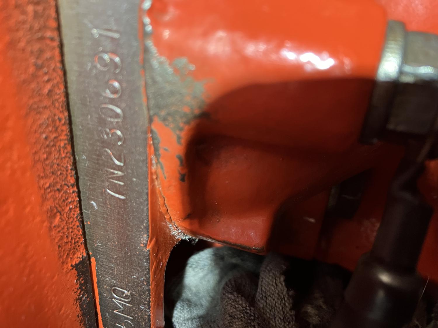

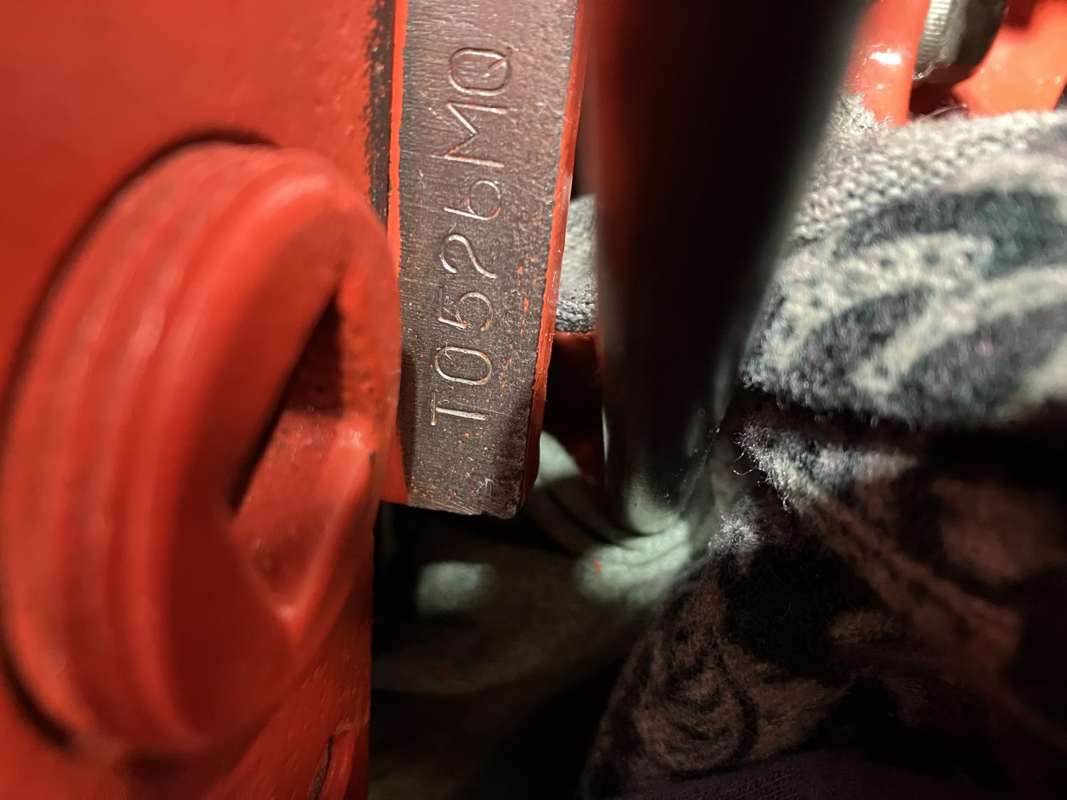

My car is 06A built Norwood. Block is a 406. Never had it looked at by someone like JMc. It is what it is, had a few 69 dated parts on it when i bought it and still does. I enjoy it.
Couple of pad pics n TT.
Richard
